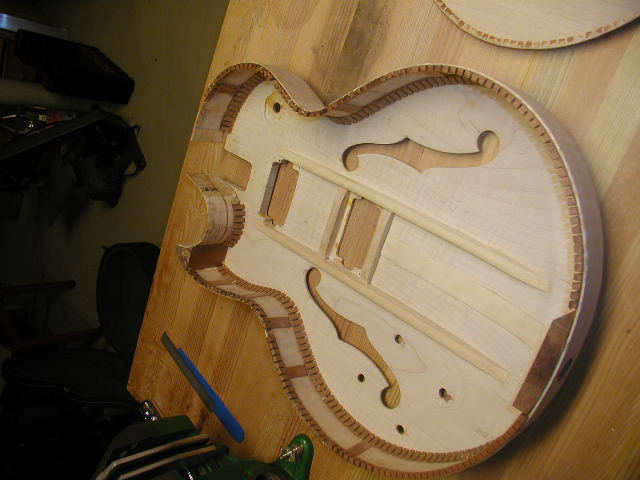

I finally had a chance to really take a good look at the mangled Heritage 575 that James Orr sent me from the swap meet, and I'm trying to plan how to proceed. The picture shows the back plate and the top plate with sides still attached. Everything else is pretty much shot.

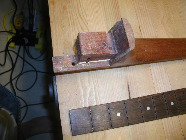

The neck attachment for this guitar is a pretty clunky, long tenon kind of thing (see picture). I'd rather do something along the lines of the Benedetto plans, but the cutout in the top is sized to fit this tenon. I could enlarge the cutout a little and go with a deep, full width fingerboard extension, though. Here is what the tenon looks like:
The fingerboard extension seen there lies on top of the top plate.
I don't like bursts on anything (aside from my Strat), so I was planning on going au natural. This means I'll have to replace the side in the area of the cutaway - as it has a nasty split that is discolored from previous refinishing exercises (I'd guess) and I judge to be unrepairable. I'm thinking koa bindings, headplate and pickup rings. I'll probably have to cut my own extra high binding strips as this has the typical Gibson wide binding in the cutout (as opposed to the constant height binding).
The necks looks to have the same angle as on the Benedetto plans (about 5.5 degrees), so I think I can follow those plans with some adjustment for the shorter scale (This is 24.625", as opposed to the 25.something on the Benedetto.) I plan to have the headplate be koa, and I will cover the back as well. I'm trying to decide between a solid mahogany neck (I have an appropriate blank) or perhaps a laminated neck to go better with the maple - perhaps maple/mahogany/maple with black accent lines?
I plan to have some fun with this, as long as I can get past the neck tenon/neck block design OK. I have an excuse now to get my Woolson neck jig built, too.

I had planned on doing a bolt-on neck with a tendon more akin to what's
being used on acoustics now, then filling that gap in the top in with a
plug that fit the tendon.

How did you plan to get inside to tighten the bolts? Long ratchet extension through the hole in the tail block? Plugging the hole for the tenon is a good idea.
